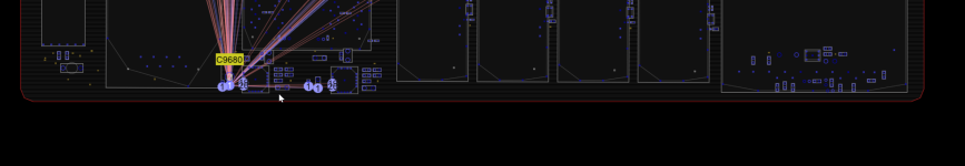

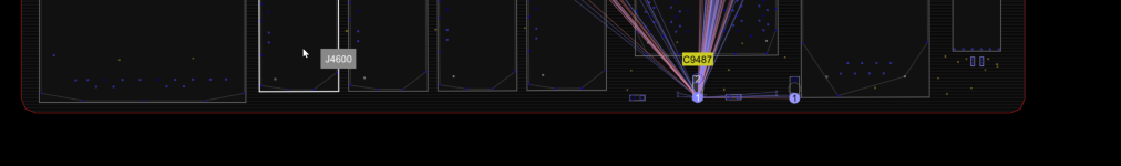

Since there are many caps connected to the 3V3_S5 and the NEAR area as you said is really TINY INY TINY LITTLE SMALLY
The pictures below are "NEAR" the corroded area.
Isn't that easy for you to confirm for me which one are those FILTER CAPS?
I do not have
  • 2023-01-11 20_36_57-OpenBoardView - C__Users_Angelo_Downloads_A1418_820-3302A_A1418_820-3302A_...png
  • 2023-01-11 20_37_13-OpenBoardView - C__Users_Angelo_Downloads_A1418_820-3302A_A1418_820-3302A_...png
Usually, "F" is used for Fuses, not for caps.
We used "filter caps" to name the caps connected to a power rail.
C9480/81/87 and C9680/81/87 are the first suspects there.
