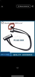

hey thank you for the schematic offer. I have Crucial SSD installed. But tried fusion drive also. I have checked the cables but I am a bit suspicious with the highlighted cable on the attached photo but not for sure with that also and I dont know what this cable for?.IMG_9529.jpeg
