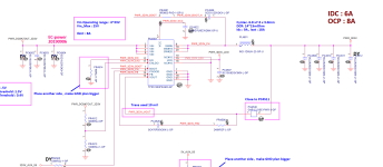

Hi Guys, I know this is an Apple sub, but not sure if you can help me with this one too. I got a schematic and boardview for a close model. location of the parts on the board are a bit shuffled, but schematic ics seem to match. Here link to the Schematic and Boardview - Lenovo FLEX 5-14ALC05 – LC56-14A SVT
I got two of these, both have been connected to the same (doggy?) usbc, which blew them one by one.
I have detected a short on the 5V line and traced it down to U7204 (which was glowing at 1V over 5V line). Replaced it, and the short is gone. However, I cannot get 3.3 and 5V lines to fire up.
PU4501 is heating up slightly and was dropping the DCBATOUT voltage from 19 to 9 V. After replacement, it now stays at 19V with no drop.
Now still slight heat signature on PU4501 bench shows 19V/0.04A
PU4501/4551, same voltages
P1 - 4.5V
P2 - 19V
P6 - 0V
P9 - 0V
P11 - 4.7V
P12 - 0V
P13 - 0V
P14 - 0V
P15 - 5V / 2.7V
P17 - 5V
