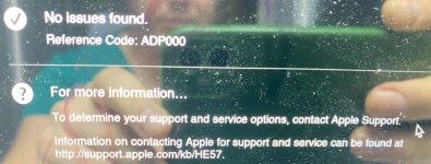

Hello. Need help. I can't install the system. The system installs normally but doesn't get past the window with critical updates. I tried command +r, command +opshin+r, I installed from a disk and it still doesn't work. And this is not the first MacBook I have with this problem.

According to the user, he reset the working MacBook to factory settings but was unable to install the system back.
Yes, the MacBook boots in safe mode.
There are no errors in diagnostic mode.
ipetro
Both articles have identical descriptions and suspicions of possible causes. But even if you turn everything off or put the board in another tested working case, the problem remains. The board is in a new, flawless condition even under a microscope. It is obvious that the problem is with the board, but what exactly needs to be looked at or replaced?
