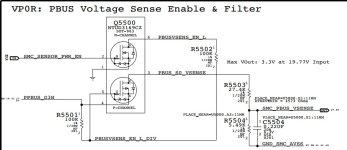

ASD reports PPBUS is too low and I measure 7.6V on the whole rail. I don´t think something is shorting to ground since nothing gets really hot.
Furthermore all the resistors in the ISL6259 area measure good values...

7.6V is fine with a battery that is not fully charged. You should have checked the actual value in ASD. Problem is probably around Q5500, R5501/02. The machine will work slow

Q5500 was the first place i looked at - I forgot to mention it
Everything measures and looks fine
I attached a picture so you don't need to search it your self
PPBUS_G3H on the left side is already 7.6V so the outgoing signal on PIN 3 is also 7.6V
The outgoing signal SMC_PBUS_VSENSE on the right side is created from PIN3 of Q5500 and the voltage divider R5503/ R5504 - all measures fine
So for me this section was OK and I went on.
My guess is there is no sensor issue but the real value of PBUS is/was indeed too low!
Which raises the question on why PBUS is/was too low?
Maybe you're right and 7.6V is fine for a not fully charged battery and I will run ASD with a charged battery again when I get my hands on it!

You can check in ASD the actual value that is being measured. It will be a lot lower than 7.6V before it reports an issue. Run EFI ASD and check under hardware profile.
