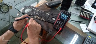

"Just 900mv on both the coils".
And is the exact voltage must be there.
Post exact voltage at L7510/20/30 in the first moment and after 10-15 seconds.
One coil is sufficient to measure.
