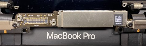

there is no image on the display but the backlight turns on, a MacBook works with the donor display! The problem is in the display itself in the controller. what to pay attention to? This is not the first display on which there is simply no image, although they themselves are in excellent condition and not damaged.

Pure white image is usually caused by missing 3.3V for TFT matrix.
Can be just a simple fuse (with shorted cap), or bad display.
