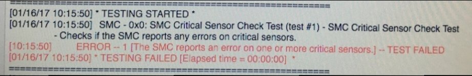

No Title
That was an image from internet, I don't have such cable, the internal 2,5" sata disk is connected only with SATA cable, for that I supposed that the temperature was read from S.M.A.R.T. Running ASD I got an error from SSD Temperature so I preferred to do what dukefawks told me and that error was gone, I will investigate later for this.
After that I've run again the ASD EFI and what you see are the errors with the original disk.
I'm searching to understand what all these (proximity and co.) sensor are.
I'm still running ASD OS (I will read results tomorrow) and still waiting an replacement for the display cable.

The sensor is on pin 11 of the power connector of the HDD, it needs to be grounded on the SSD. I normally open up the SSD and ground that pin with solder. It is in between to GND pins.
But looking at the ASD result the SSD is not the only issue. The multiple sensor failure indicates a data bus issue. Can you see what temperatures the failing sensors are reading? Best to run the EFI version of ASD for this.

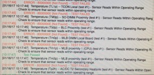

No Title
The posted image was from EFI ASD. But I don't know how to see the temperatures.
In OS ASD I get more errors.
But I don't know if these are useful or not.

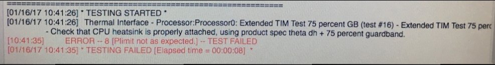

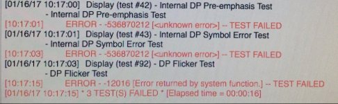

System is not seeing the sensors which usually means there is an issue on the data bus. I bet the data lines are shorted in the LCD connector or cable. Inspect the connector for damage.

I can't see damage on the connector, changed motherboard and all went fine, (same display same cable), so the problem is definitely on board.
I haven't modified the ssd but as I told you I can't see issues working with it, no high fan speed or slowness. Maybe I would get an error on temp sensor if I would run the ASD again.
Could you tell me if there are other consequences running the mac in this way.
Now I have the broken board and I would like to fix it.
Could I try to replace something? Or investigate in some way? Thanks
