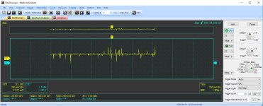

OK, got an oscilloscope. Never worked with one, but on a working machine if I measure PCIE_CLK100M_SSD_P or N, the curve and spikes looks the same as on the working machine.
