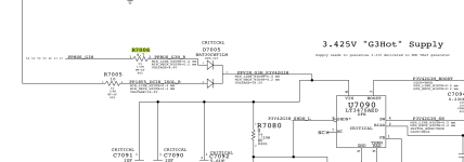

Getting back to this board.. I'm getting a green light then amber, no fan. Check R7006 for V and immediately get fan spin for 12 seconds on, off, 12 seconds on, off - USB mouse light on the whole time until i remove probes. Same with R7005. Same with meter off.
Hit the SMC with some heat/ flux. Power supply and 3 different chargers, known good DC-in and cable.
R7005 is on PPBUS feeding 3V42 circuit. I see no reason why the board would power on when touching this. I also see no reason to measure anything there as green/orange light is present so 3V42 must be present. R7006 is not in the schematic. Check what you are measuring.
ThisIsWes:AASP
No Title
See image for R7006.
I've had this resistor be the issue with a lot of MBA's. Some even with the light. I always start there to see what I'm getting...
Oops, I was looking at the 3476 schematic. Still no idea why it would power on when touching that. Is 3V42 present and stable? Crap under the SMC is still suspect.
