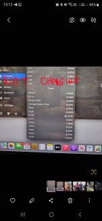

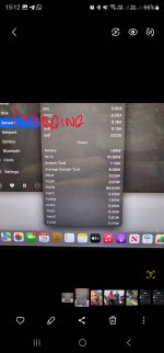

Install HWMonitor and look for strange I/V sensors value.

Regard the HWMonitor I could not find it for Mac.
What is I/V sensors?
Can I use TG Pro to check these sensors?
ronaldo
This are the readings.
