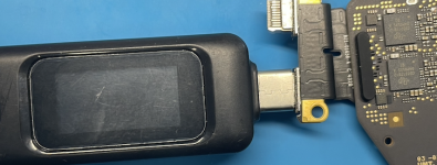

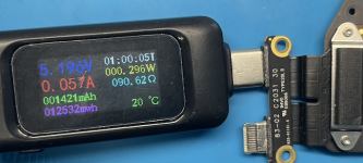

Hey guys,
got something strange here. Customer told me, he changed the screen, then not working anymore?!
Board looks fine / no visible damage.
One CD3217 taking aroung 0,2A, should be working.
When i plug into the other port, 0,05A. When i connect to the same port, but flipped board, the amp-meter stays off / not taking any charge... (see pictures)
When i plug in to the working CD3217, PPBUS_AON = 12,03V.
Whats going on here?

tried another flex. same issue.
CC1/2 diode mode readings same.
i noticed when i plug into the working port, the chip is getting around 40degrees celsius. (left area)
when i plug into the not function port, the chip is getting around 60degrees celsius. (left area)
is it the chip?
when i plug into the not working port, when usbc meter is not showing anything, i get 3.2V on USB1_CC2
edit: when i plug into the not working port with amp meter showing something, pp5v_S2 is 3.3v.
area getting hot is pp5v_s2
