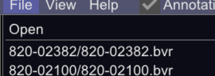

I saw you already worked with a boardview.
From which board?
If corresponds, that is your board...
leoFUSE
You'r absolutly right. I worked with the openboard view software.
I guessed that there is only one M1 2021 mobo model in the 16 inch version.
I downloaded the file 820-02382/820-02382.bvr
As I used it to mesure "PPBUS_AON" on the fuse I guess so far it is the right one.
