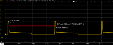

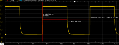

Nope it is solid right now at 1.5V. It did used to be around 12.5V with some fluctuations but since then we have removed a few components so not sure if that should be expected.
OK, we start from scratch then.
Remove F7040/1 and check if get stable C7040 voltage.
SMC_PM_G2_EN should stay at 3V.
