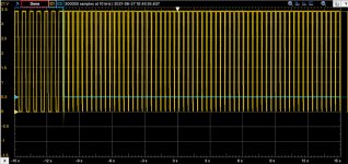

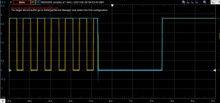

Understood. Please see the attached images for what I mean by grounding. The blue line is the scope of the "trigger". The pulsing is still there.
yep still pulses, as shown in attached images

Keep SMC_ONOFF_L down more time, it should turn off the board.
Only 3V3_S5 must remain present after and no pulse on other coils.

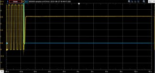

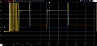

Not sure what happened but the behavior changed. So this is the process:
Power cycle
L7260_1_1
Disconnect SMC_ONOFF_L
L7260_1_2
Power cycle
L7260_2
So it looks like the behavior changed after the first long press of SMC_ONOFF_L. Now it seems like grounding SMC_ONOFF_L causes the PP3V3_S5 to go to 2.5V as opposed to pulsing. Then after grounding is removed, the voltage stays constant at 0.5V. The pulsing does not return until the board is power cycled again.
After power cycling, the pulsing starts again. During that time, the other coils that show pulsing (L7770 for example) continue to pulse. However, after the pulsing stops (after holding SMC_ONOFF_L for more than 1 second, as stated above), those lines go to 0V.
Also, not shown here, after power cycle, and while it is pulsing, when I do a short "press" of SMC_ONOFF_L, grounding for maybe 1 second? the voltage jumps to ~2.4, and then when ungrounded it stays at 0.5V. However, if I just "tap" SMC_ONOFF_L, grounding maybe 0.1seconds?, the voltage jumps to ~2.4, but when ungrounded goes back to pulsing.
