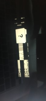

And yep, replaced U7100 put back 100 ohm. Powers on but there's GPU / VRAM lines on the screen.
down1nit
Do these respond OK to modifying nvram and then depowering the mux vcc?
Or is this a thing I need a demux setup for?
