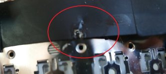

I just have an 820-3787 here it had a hole in the board near u7100 and no power on
I replaced U7100 and soldered the missing traces. After that it worked, Trackpad working, keyboard wrote what it want. Then with a new Akku I noticed that It consumed 4-6A, after that I limited the curent to 3,5
I found that R7121/22 are bad. After replacing current was normal (about 3.4A not rising anymore)
Now I found that the damaged U7100 burned a hole in the Keyboard cable until the metal of the keyboard.
So I replaced the keyboard. But still the same problem.
