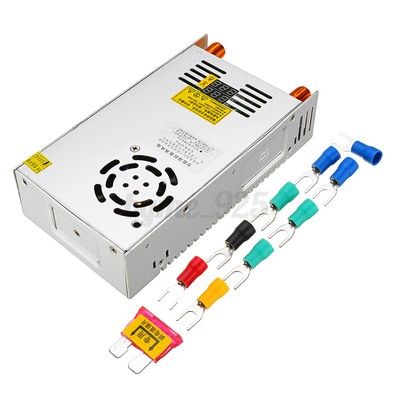

Why don't you get first a 24V/20A lab PSU first?
Some links posted on the forum.
As seen you need one for testing iMacs.
Very usefull also to find shorts on any other logic board.
mushr00m
Tried to find something in Aliexpress and didnt find. Just found one with 60V/6A. Can you give me a link of one that you recommend?
"Some links posted on the forum."
I don't understand why people prefer to wait hours, instead of searching on the forum/Internet.
Better price on Alixpress for sure.
