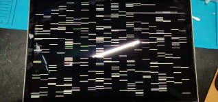

OS on external HDD gives me this. First boots normally, but around a half filled loading bar it starts behaving like this and reboots after ~30 sec

Used your BIOS and cleaned ME afterwards. Verified and all. After starting the ME changed which means the PCH has turned on. I can see some indication of waterdamage near the BIOS connector leading under the RAM heatshield. Any way to remove that thing? Since 500 celsius and 120L/min wont do.
Roan
Wont start any MacOS recovery. Can choose wifi, but the loading bar after that does not got further than halfway.
