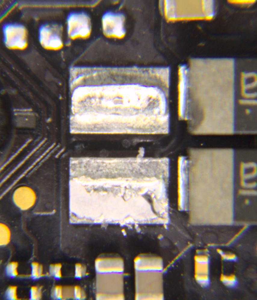

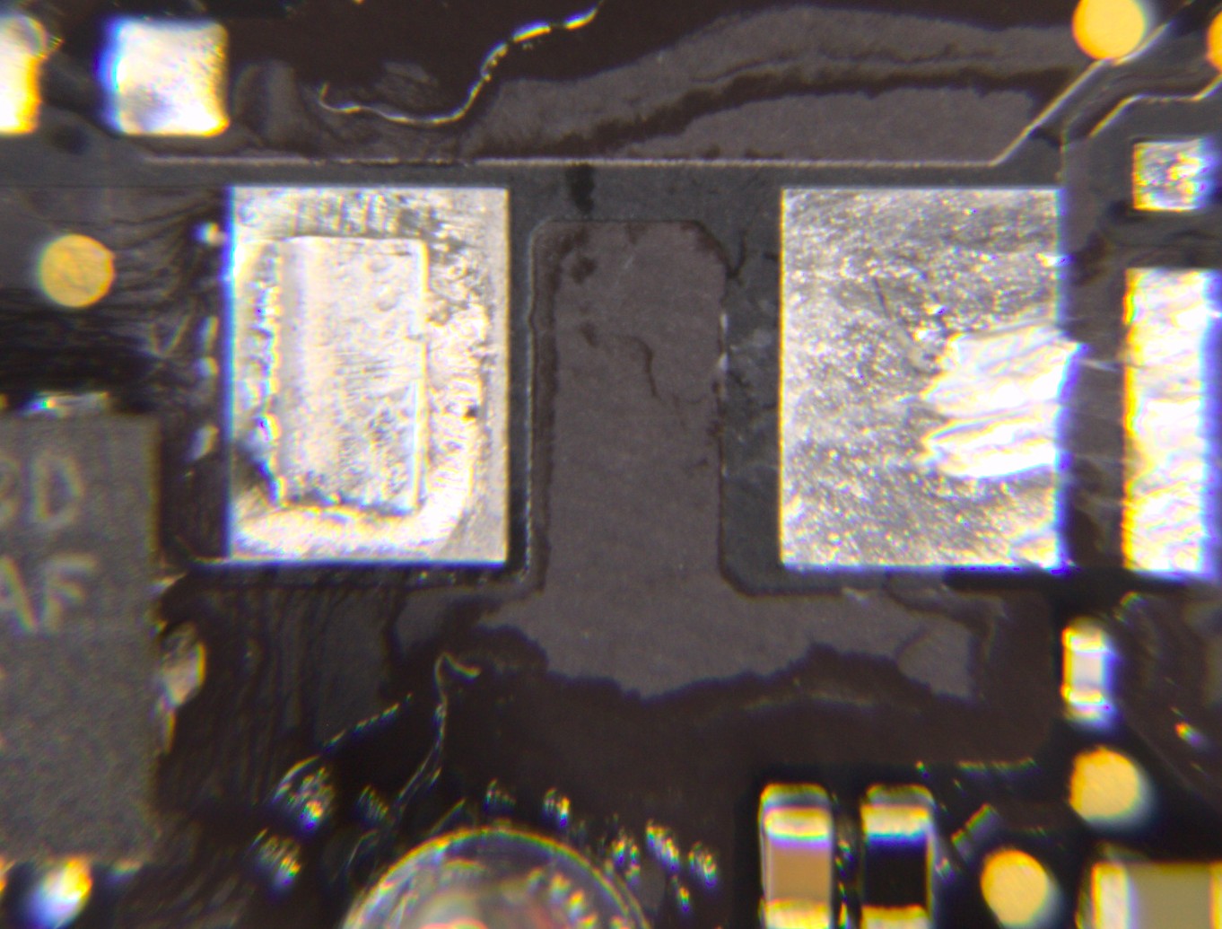

PP1V_S5G = short (Or just inductor (L8060,L1250,L1252,L1253,L1254) ?)
PP1V8_S5G = short (Or just inductor (L7930) ?)

Considering I am seeing a small voltage on PP1V_S5G and PP1V8_S5G with the charger connected, I assume that those aren't shorted? Otherwise I would proceed by lifting the inductors and checking if the short remains. Can you help me with how I should proceed?
