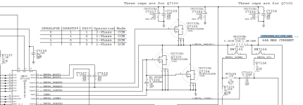

4.97v across L7320
While I was moving the board around the charger light came on.
reseated the power cables and the green charge light came on.
That is my inexperience.
Will go through all the rails over again.

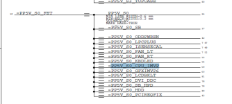

Going down the power rails

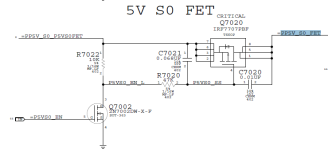

PP5VS3 missing
PM_S4_STATE_L missing on Q7002
Which goes back to U2300 Chip

This was tough one. I have 3.4v at R5070
I don't get any pulse SMC_ONOFF_L when I short the pads.
It remains at 3.4V.
No voltage at pin 45 on u2300. Its tough to measure this one. I was wrong previously.
R5015 pad 1 is placed on SMC_ONOFF_L.
Pad 2 is ground.
How can't drop SMC_ONOFF_L, if you tie it to ground???
