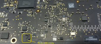

When I opened laptop, I noticed that the board is very clean with tiny trace of corrosion (green) on one place on the board and what I noticed immediately is that there was some kind of previous repair attempt. The load switch U8030 was desoldered and removed from the board. After visual inspection I cannot determine if something else is removed but it seems not.

The corrosion (green color) was around C1930 and this caps is not present on the board. There is a resistor R on which R1931, on which I measure 10.8 kohm and 1.05V

Buy donor board and replace missing/corroded parts.
Of course it doesn't match with the history of dying after macOS upgrade (which would rather be corrupt SPI ROM for example), so either customer isn't telling the truth or you don't have the original board of that MacBook in front of you.

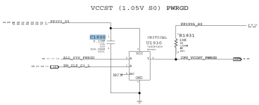

Hello piernov and thank you for your reply. Yes, I concluded the same regarding the history. As for corroded parts, there is a trace of teh corrosion only on place of C1930. This cap is no longer on the board and I don't think it is necessary to find a replacement cap. I do have PP1V05 and it is stable 1.05V. This cap is filter on PP3V3_S5. So the board should work without that cap. But I wonder about U8030 chip?
So, the board cannot work without U8030, is that right conclusion?

Always replace corroded components and don't leave them off, this is the basis of quality work. The machine can work even if certain caps are missing (and sometimes even other components), but it doesn't apply to all of them, and the machine can get unstable if it's missing caps.

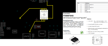

Since U8030 is a load switch TPS22924C with the following characteristics: current = 2A Max, Ron = 25.8 mOhm at 2.5V and it will take more than a week to be delivered, I was thinking to use an alternative one with (what it seems to me) better characteristics. I think I can use FDS6676AS N channel MOSFET. This chip is significantly bigger than original, but there is more than plenty space on the board. I was thinking I can make something like shown in the attached picture. Someone may consider this doggy, but it could work.
Please tell me what you think.

Askaleto
At first glance, I rejected this idea, because I need to have MOSFET ON at 2.8 V( 3.23V-054V). But I saw that typical treshold voltage is 1.5 V and max 3 V for this MOSFET, so I made little experiment on a desk and it opens on about 2.7V, which is really at the edge. Probably, this will sometime works and sometimes doesn't depending of the temperature. But since I have a few PC notebook boards, I found one more type used and that is AON7408 30V N-Channel MOSFET . This is also on the edge, but on the schematics I found that this creates 1.2 V. Perhaps, I'm interpreting something wrong, but that is why I'm asking before actual testing. Like Louis said in one of his youtbe videos "Never be afraid to show to others how dumb you are" :)

Get correct chip replacment and stop to waste your time.
A power MOSFET requires 5-10V for Vgs to work properly.
Lower voltage will mean higher internal resistamce and can be fried.

You need to have at least some electronics knowledge to be able to fix a device as complex as a Mac logic board.
As the name says, Vgs is voltage between gate and source. If you have 3.3V with respect to ground on source, it means you need 3.3V + Vgs on the gate with respect to ground. Also an ideal MOSFET doesn't exist, the on-state resistance progressively increases when Vgs decreases (ie. low Vgs = higher losses = higher power dissipation).
Please stop messing with customer's boards worth $300. Additionally performing low-quality repairs is the perfect way to discredit the whole third-party repair industry. If you watched a lot of Louis Rossmann videos, these concepts should be clear as well.
