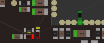

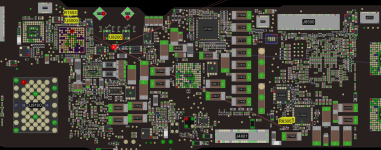

hgoncalves
Active member
Hi, yes, I'm using 00244 schematic and boardview.
I've checked continuity of PM_SLP_S5_L from U8200 to U7650, but it doesn't have continuity.
The schematic doesn't have it, but the boardview shows it (R8305).
Then you don't have PM_SLP_S5_L.
How then do you get 5V_S4?
Possible there are more differences between board and schematic.
If PM_SLP_S5_L is really present at U7650, then wire it to U8200.
