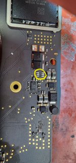

Trying to trace SSD Nand power. Schematic shows U5910. I see soldered pads, but missing ?
Doesn't look ripped off?
You may have lot of damage on the board now.
Replace U7600 and pray!
Be sure R/C7609 are both good; as their traces too.
Trying to track down the data sheet for 58879D CSD55879Q3D = U7600
Not finding a whole lot. Ordered this as the closest I could find from Digi key
