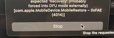

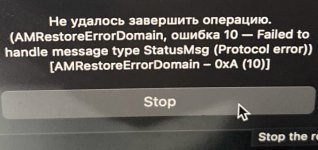

macbook in dfu state.
5v/0.043A. all 4 ports readings are the same with or without battery connected.
when trying to restore, different errors appear. 10, 1014, 9, etc.
PPBUS_G3H= 12.34v

did not turn on and the display was cracked and needed replacing. I installed my working test display but nothing worked. I checked if it was in the DFU since the behavior of the ports was the same and it was in the DFU. I tried to restore it but different errors occurred. I transferred the board to another case and the board turned on already from recovery. It was restored without errors! The MacBook is charging and the fans are spinning but the caps lock is not lit and there is no image on either the built-in or the internal display!
