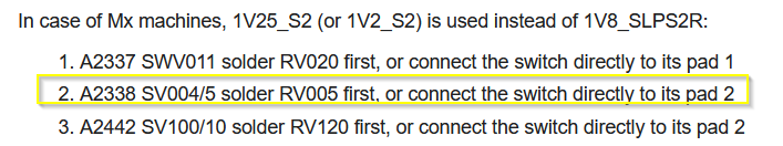

I'm unfamiliar with the external switch method. I don't understand the instructions, because the device will not power on, how will I put it in DFU mode?
tawnytim
Thank you for the link. According to the instructions in the picture, can I just connect SV004:4(SOC_FORCE_DFU) to RR503:1(PP1V25_S2)?
Yes, if you like.
Isn't more easy to do it as in the link?
You can join RV005 pads with a solder blob.

I don't have voltage at SV004:1 or RR503:1. I can't find pp1v_25_S2 anywhere. This board is missing components where my boardview software shows them.
"You can join RV005 pads with a solder blob"
Then solder external switch over SV004 pads; 1-2, or 3-4, how you like.
Try to put some logic on your job.
Interpret a schematic, not just watch it.
tawnytim
I hear you, I didn't have a schematic, only a BV. But anyway, I understand your instructions, but just want to clarify one thing. To do what you're talking about, I will need to remove the board, join RV005, then reinstall the board - this is correct? I didn't see a way to get to RV005 from the top of the board, but you are far more experienced, and the techs over there are super fast, so I want to make sure I'm not making more work than necessary.
I don't have such board on my hands.
Find a convenient point for 1V25_S2; to avoid board removal.
Connect the switch between such point and SV004; pad 2, or 4.
