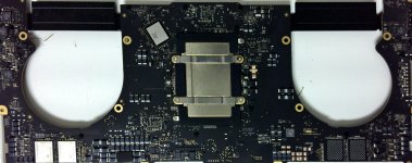

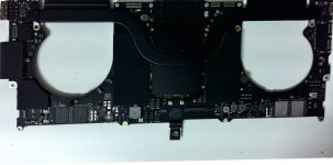

We have Apple MacBook Pro A2442 and the laptop don't charge. We checked all ports with USB-C meter. All ports uses same volt and ampere (5.21V 0.03A). We removed the Logic Board from the laptop. We inspected the Logic Board and could not find any visible damage.
zeydullak
I need your help in this situation to move forward and to troubleshoot the issue. Please advise what to check. Thank you. See attachments as well

Laptop doesn't charge, or doesn't turn on at all?
Please post accurate information.
With 5V input, I expect a non-working machine; not just not charging...

Yes the same behavior on Magsafe 3 port. Voltages for PPBUS_AON and 3V8_AON missing. Please advise what to check next? thank you
zeydullak
Diode mode to ground is missing as well. It shows 0.0001 mvdc for PPBUS_AON and 0.3 mvdc for 3V8_AON. I put the multimeter on diode mode, put the red on ground and black on element.
Also we tried to remove F5200 from the board but 420C hot air cannot remote it. It does not get melted. It looks like they use very hard material. Please advice how to remove it. How do you do it? thank you
