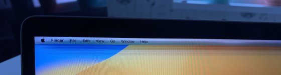

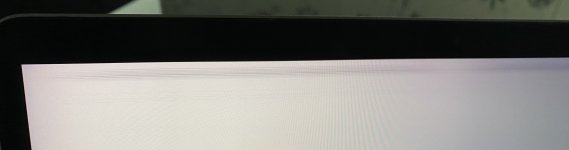

Help me repair my MacBook display. The display works properly but from time to time a shadow appears at the top of the screen.

If you locate the problem as being the LCD assembly, no way to repair it.
Unless you want to change LCD only.
Difficult and risky job...

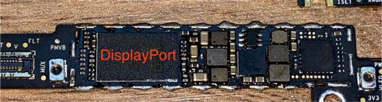

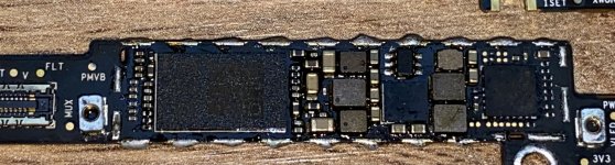

I understand that the problem is with the MacBook board. replacing LSD is easy but expensive. 🫰 I just need help understanding what is responsible for what on the display board since there are no such circuits.
after replacing the entire board from another display of the same model, it leads to image loss. when replacing a large chip to artifacts. As I understand it, there are some microcircuits that need to be transferred to a new board . I will be glad to receive any help and information specifically in repairing display boards. I will be glad to receive any help and information specifically in repairing display boards.

Usually the DisplayPort controller and its EEPROM.
I think we have a similar thread on the past week on the forum.
ipetro
Can you tell me where the EEPROM is located in these photos? Is DisplayPort the biggest chip?!
Yeah, the biggest chip.
Its EEPROM should be close to it, possible on the opposite side.
Search with Google for some marking codes...

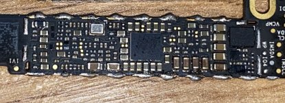

ipetro
all chips that have markings. We found out where the display port is, but where the EEPROM is is not clear.

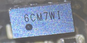

ipetro
yes it looks like 4GDK EEPROM
Do I understand you correctly that you cannot transfer only the display port, it is also necessary to transfer the EEPROM, otherwise it will not work?!
Some LCD dependant parameters are saved into EEPROM.
So the EEPROM is paired with LCD.
Don't forget to make backup.
