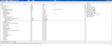

I extracted the bios from an 820-3115 MBP using a CH341a programmer. Is there a program that can get this into a readable format so I can see basic information about the computer (ex. serial number)?

UEFITool NE to browse through the EFI modules and NVRAM variables (most likely what you are looking for right now), ME Analyzer to get info about ME region, Intel FITC to get some configuration bits of the Intel platform.

I downloaded UEFITool NE and searched for SSN. It specified the following destination: EfiCrc32GuidedSectionExtractionGuid/PE32 image section at header-offset 314Ch. After navigating there, the contents did not show anything related to the serial number. I attached a screenshot. What am I doing wrong?

I extracted the file (PE32 Image Section) and opened it with HxD. I attached a screenshot. For the most part, the decoded text is just nonsense. I feel like I'm doing something wrong though because when I open up a known working bios file in HxD the decoded version is also not intelligible.
awbower
I take it back... for some reason the search function didn't work initially. I tried it again and found the serial number hidden among all of the gibberish.

Building BIOS file from a chip read from other board, will require changing serial number.
This also imply fix checksum of Fsys area.
