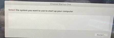

When the option is pressed when loading, the MacBook sees the internal disk. but with command+r in disk utility the disk is missing.

When loading normally, a folder with a question mark appears. I can’t boot into target disk mode because it doesn’t see the ssd.

When you turn it on and hold down T, the MacBook goes into target disk mode, but it is not displayed on another MacBook.

In all such videos, they do not display the hard drive at all when loading when the option is pressed! I have it in the list of devices, but it’s not in the utility to install the system on it! This is the third time a MacBook has had this problem and these tricks don’t work with the heat.
ipetro
After repeating the actions with the video, the disk is no longer detected! As I understand it, at this stage repairs are impossible or unrealistic!
These boards end with dead CPU, soon or late.
I don't recommend to accept them for any kind of failure.
You may repair a power issue and client comes back to you claiming for warranty, if CPU dies in few months.
ipetro
thanks for the advice . I returned this one without repair! Does it make sense to take these models for repair at all or refuse to repair them right away?!
