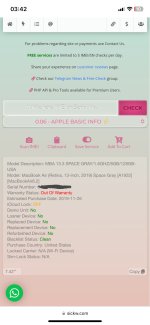

The MacBook turned on but there is a but! I can’t complete the activation!
The MacBook must be removed from the actual Apple account first!
I tell you this from experience.
Even if no service is enabled on the account, you can't go away untill delete it from Apple.
Apple support doesn’t understand why he doesn’t connect to their server and can’t help! THE BEST)))
I deleted it from my icloud account but it didn't change anything!
We don't have access to BIOS on T2 machines.
Anyway, BIOS should be restored in DFU.
You can try DFU restore with empty SoC ROM (U4770); that is not BIOS chip!
Didn't help in my case.
Problem was solved once MacBook was removed from Apple account.
I apologize for the stupid question, but what role does the SoC ROM play? The serial number, as I understand it, is registered in the SoC ROM?!
