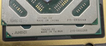

after replacing the video chip of the GPU Radeon, the picture is only in safe mode and it slows down a lot! after replacing, I restored it via DFU without errors! What could be the problem?
ipetro
the chip was removed from a similar blocked board. Please see if they are interchangeable?
The first photo is old. The second is new.
Not exact the same; one ends in 52, other 68.
A2141 BOM lists many NAVI14 GPUs.
There may be some configuration differences.
Compare GPU pinstrap resistors from page 116.
You should copy the configuration from donor board; depends if has the same vRAM size.
