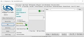

Upload somewhere original BIOS.
BTW, we have CONFIRMED clean ME BIOSes posted on the forum, for this board.
czechrepair
I flashed the bios you send me. When I boot via usb, It show apple logo and progress bar seems to complete then blank screen, only backlight work. It will stay in blank screen forever :(. It doesn't shutdown this time. Cap lock not work.

Please, don't mix the problems here.
Open new thread with any board.
Which board needs BIOS clean ME now???
