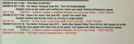

MacBook Air 820-3437-B fans spin at max RPM
No-Clean
Yes 2 new fans and same thing, J6000, Q6060, U6010 all look clean, after I tried a new IO board and flex it worked fine, but I put the old IO and flex back on and it is also working fine. I will leave it alone now that it works and hope it won't come back.
