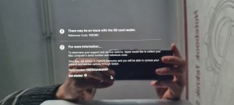

Starting in diagnostic mode shows any error?
isc
i already test more than 3 macOS from a SSD preinstalled in other machine but always freezes,
the same situation on other bios ,
diagnostic mode shows this error
