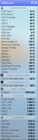

I have repaired the board 820-00165-A, by replacing U8030. The laptop worked normally for a few hours and then fan just ramp to full speed.
At first I didn't notice any performance issue (YouTube, Netflix etc worked without glitches). Later I have found out that CPU speed is limited to max 1.0 GHz, but according to the specifications it is 1.6 GHz I5-5250U with Turbo boost up to 2.7 GHz, 4 GB RAM , 128 GB SSD.
HWMonitor shows that 4 sensors are failed (actually 5, but "meomory proximity doesn't exist in reality). Below keyboard cable is liquid presence indicator and it is white, meaning water wasn't there.

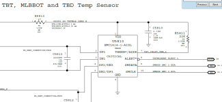

So, I need further advices. I believe that issue may be with U5810, if all those 4 sensors are connected to the same chip. According to the schematics (page nr. 44, this chip is for TBT, MLBBOT and TBD Temp Sensor)
So, I kindly somebody here, who have the same MBA with the same motherboard, is it possible to disconenct the trackpad. then starts laptop and post HWMonitor readings?
How to proceed further? Should I check if supply voltage is present on U5810? This chip is on the other side of the board and is not easy accessible.

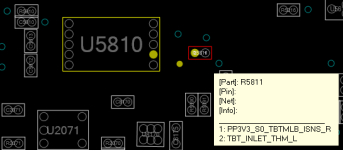

Ok, here is an update. Checked with another flex I/O cable and the issue is still the same. Now, I examined the area around U5810 more closely and found nothing suspicious, but when I measured the resistor R5811, which is 22 K according to the schematics the multimeter showed 4.5 kOhm in one direction and 3.5 kOhm in another (reverse MM plugs). I measured while component is still on the board, so it is not a 100% reliable measurement. Anyway, when connected to the charger, pin 1 of R5811 (PP3V3_S0_TBTMLB_ISNS_R) was 3.28V, but pin 2 (TBT_INLET_THM_L) was 0.12V.
Now, I know that _L means that signal is present when voltage is low, so I ask for your opinion whether this is OK. But on the other hand, maybe because this signal is low, this means that chip will consider this as a thermal issue present. Not sure how to interpret this. I would expect after 22 kOhm resistor to have voltage but don't know how big load U5810 chip is.

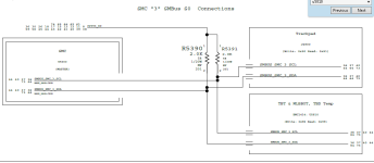

I doubt that LIO could be in any connection with this problem. According to the schematics, Trackpad shares SMBUS_SMC_3 and it has connection to the lines that go to U5810. HWMonitor shows Palmrest (trackpad) and 3 other sensors to be 128 °C.
Pull up resistor R5811 is critical for addressing. If this resistor is out of specs, the address will be faulty and there will be no communication.
I would like to ask anybody who has 820-01165 board, to measure resistance of R5811 (while on board) and confirm if the reading is about 22 kOhm.

After double check, the R5811 is 22k. My multimeter was not good. So I‘m back at the beginning. Is there any way I can check on SDA and SCL SMbus 3 in diode mode to ground to try to find out what is the problem? I don‘t have new LIO board, but don‘t understand how this could influence Palmrest reading. According to the schematics, LIO sensor doesn‘t not share same bus line. Also battery charging works Ok, audio as well as USB. It is very unlikely that LIO has a fault that only influence temperature readings.

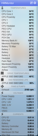

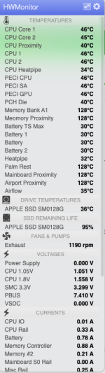

Well, after more than a month struggling with this unfortunate repair, I can say that I have fixed the problem. After all, the job is to make the customer happy. The palm rest temperature (which was the main reason for throttling and fan full speed) is measured as normal again. The problem was U5810 which caused disturbance on SMBUS_SMC_3_SCL/SDA.
The problem is eliminated by removing the U5810 chip completely from the board. I have tried once before to replace it but that didn't solve the problem.
It's like pulling out a rotten tooth. Now I have the HWmonitor readings like attached. Also during stress test CPU enters turbo boost and is no longer limited to 800/900MHz. The laptop is made great again and this reminded me why I used to avoid MacBooks.
