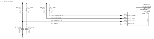

Check the 4 PCH's RTC signals.

In regards to checking the 4 PCH's RTC signals... what pins should I be reading with an oscilloscope?
I can only see PCH_CLK32K_RTCX1 in the board view...which I should be able to get a probe on at U1900.

"4 PCH's RTC signals."
If you look inside PCH schematic, I'm sure you will find the signals.
RTC block is clearly marked (page 12).
No need of o-scope, these are DC signals.

To be more explicit:
RTC_RESET_L, PCH_SRTCRST_L, PCH_INTRUDER_L and PCH_INTVRMEN.
All them are connected to a clearly delimited RTC block inside PCH.
