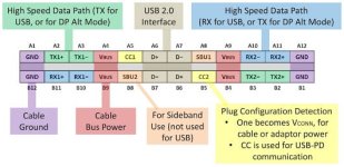

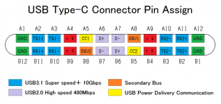

Replaced Q3200, area no longer hot and the port's is now getting 20V, but the port only works when the USB-C is plugged in one way, if I take the plug and flip it over and plug it in "upside down" I get nothing, not even 5.2V. Not sure if this was happening before (though I didn't think so) had never even thought to look for it.
Is it fair to say this is a U3200 issue? what specific lines have to do with USB-C orientation?
