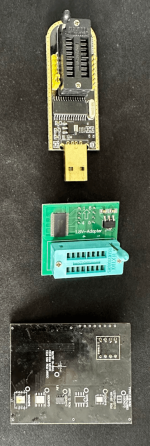

Did you connect the 1.8V adapter correctly?
Post some pictures of your programmer and SPI chip connected.
mushr00m
Images attached below
Image 1 = everything attached and connected
Image 2 = Just disconnected the adapter and the blackboard on the position it was connected
Image 3 = The DOT on the IC is pointing to the DOT on the blackboard
did it exactly as we talked before

Seems that you've connected 1.8V green adapter in reverse way into CH341 programmer.
CH341 usually has marked the positions for 24X (EEPROM) and 25X (SPI) chips.

How could I attached it wrongly if since the beginning I am taking pictures and asking you if I am doing right?
mushr00m
If my connection is correct what could be wrong?
brand new BIOS IC
Many test since the beginning of this thread
