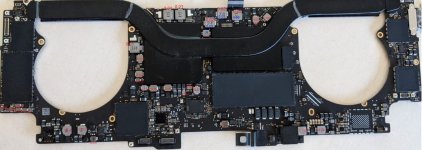

820-01827-A - Sudden death - 19V missing all USB-C port
You've marked CHGR_CSO_P on U7000; it is connected to F7000/1, as PPBUS_G3H too.
Check direct between PPBUS_G3H and coils marked with 0.02.
You should get 0.05, or 0.01; let us know.
I can't read the values on the SSD coils...
samstown
PPBUS_G3H to the three big coils(0.02) = 0.05
I've added SSD pics.
That means the short don't come from a secondary power supply.
Just in case, did you check L3500 and L9580 too?
Are placed on the other side of the board.
samstown
Thanks
L3500 to GND = 0.442
L3500 to PPBUS_G3H = 0.468
L9580 to GND = 0.0
L9580 to PPBUS_G3H = 0.003
L9581 same as L9580
OK, the short is now found; it is U9580.
Remove U9580 and check diode mode to ground at L9580/81 again.
If still short there, at least one NAND chip is fried.
The short from PPBUS_G3H to ground, will of course disapper.
