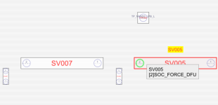

slimmy182
Forcing DFU need to be done bridging these pads? Or you mean by standard way?
slimmy182
Yes, this is M2 but the process is the same for M1 MacBook Pro 13". Anyway no luck on getting DFU whit keyboard thing. Maybe I need to try DFU force using jumper? Wich pads I have to bridge with SOC_FORCE_DFU ? thank you.
slimmy182
Tried with RV005, but no luck. The fact is that I don’t have any voltage in PP1V25_S2. Additionally, PP3V3_AON is at 0.35V.
