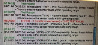

* ERROR 1 ( Unable to read sensor) Test Failed
Temperature ( Ts0P) palm test #1
Do you get only one error in ASD?
Run it in Continue mode.
That error is still related with trackpad (Palm Rest temp sensor).
Change the motor; see if other errors disappear.

asd is very slow working , takes 1 hour
Yeah, the first error is about right fin stack proximity (Th1H), not palm rest.
Pay atention when you read the ASD messages!
Check Q/U5520 areas.
Your machine has only one fan, I don't understand how do you get messages about two fans.
In fact, left fan is reported as OK.
I suppose you didn't use proper ASD version.
Try ASD EFI 3S144.
