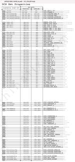

This three are shown together on page 72 in the schematic:
PCH_SRTCRST_L = 3.3v
PCH_CLK32K_RTCX1 = 0.4v
RTC_RESET_L = (3.3v
These are the only signals with PCH and RTC in the name (searching in FlexBV).
Searching for RTC only, i found this two signals more:
PPVOUT_S0_PCH_DCPRTC = 1.4v
PPVRTC_G3H = 3.3v
Maybe i have a shitty boardview and schematic for this board? Should I look for someone else?
