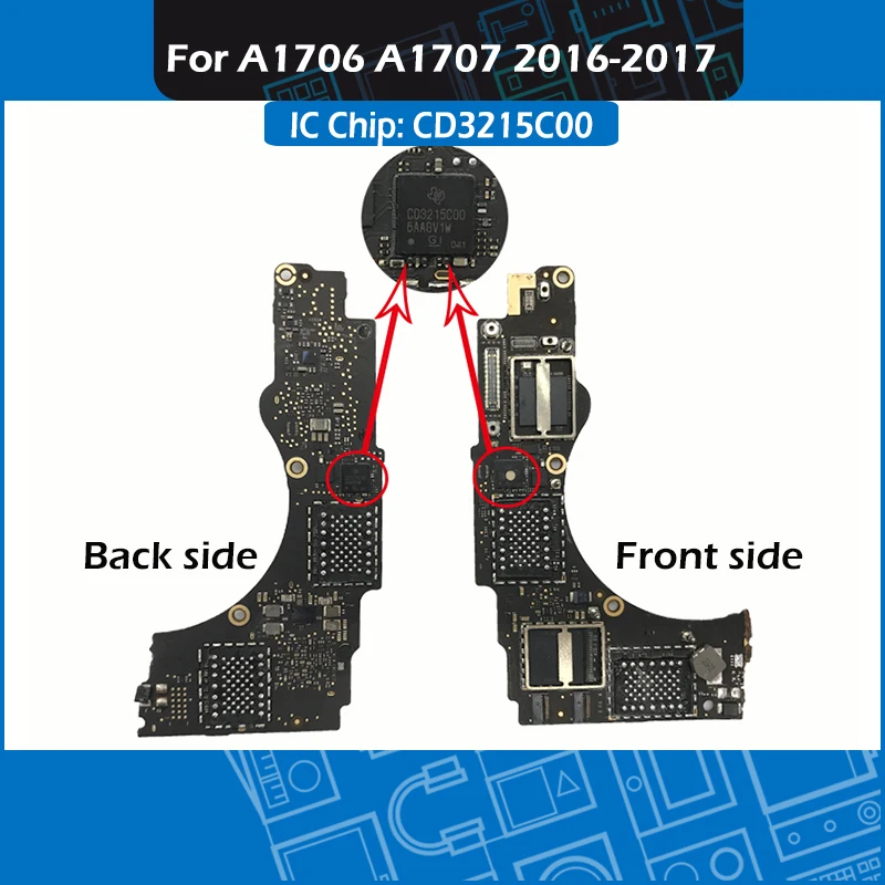

JB500 has 2 USB-C ports.
Each port has 2 ways conection possible; 4 possibilities then.
Check which CD3215 gives the steadt¡y 5V.

Is there any way for me to confirm if the chips are ok? When i changed both, the meter went from black to reboot, and now i get 5V on both fuses, and a steady 4.97V on one of the ports (with original CD3215 UB300).
Too many "new" fake chips from China.
I prefer wing boards they sell after cut off the main logic boards.
You can expect 10-30% of burnt chips.
At least the you can get original chips.

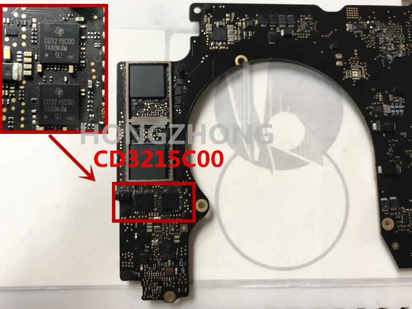

I have a scrap board here from a 1706 and tomorow i'll reball those CD3215.
Can you send me some link from where you buy those wings?
Tks.
hgoncalves
Active member
Hi,
I replaced again both CD3215 (U3100 / U3200) for two from a scrap board, but with the same result. The meter is rebooting on 3 ports, and stays steady, at 4.97V, on one of the ports (UB300). All LDO lines are as they were before.
