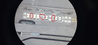

There seems to be damage to some coils:
L1290
L1275
L1295
L1270

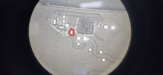

and in the TestPoint
CPU_THRMTRIP_3V3

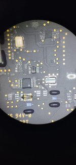

u2071 looks a bit weird

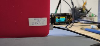

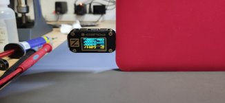

yes, it has 5v on each port
I asked about activity, not power...
