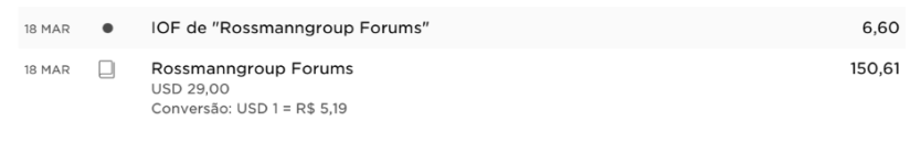

Not sure you see my question but it's NOT easy to pay it (see image attached below) for help
