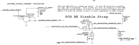

I changed q5490 it was corroded and these are the values:
PIN 1 0V
PIN 2 3,26 v
PIN 3 16,63v
PIN 4 16,62v
PIN 5 8,24v
PIN 6 1,1mv
Pin 6 should be 1,1mv?
is dcin voltage sense failing in ASD?
I couldn't run the EFI ASD or OS ASD the mac shutdown automatically, anyway I´ve measured in diode mode the q5490 and was shorten in several pins...I remove it and it flew to the fifth dimension, I don't have another one so I need to wait until another donor board arrive 30 days or so :(

Ok I have received the q5490 but it is quite strange, I´ve soldered one and in diode mode the values are:
PIN 1: 0.00
PIN 2: 4.67
PIN3: OL
PIN 4: 4.15
PIN 5: OL
PIN 6: OL
There must be something wrong, did I put the mosfet in a wrong orientation?
Could somebody give me the correct values of q5490 in a 820 - 3115b?

No reason to measure diode mode. Do you have 12.6V on pin 3 with AC connected? Also why waste time on this circuit if the board is not even working right now? Q5490 does not affect basic operation.
