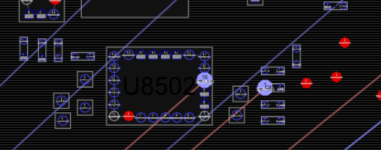

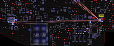

Images of the areas that I am looking
PSU @ 4V/2A goes to 1.2A when shortening this line.
